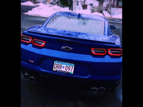

      I would ask them what is too much for the v6 to handle? That doesn't make any sense. This is a video of the Borla Atak on a 2019 V6 Camaro and I don't hear any rattling?
      There is no such thing as an exhaust that is too much for the V6 to handle. My money is that they aren't familiar with working on these cars and they did not take the time to fit it properly.
