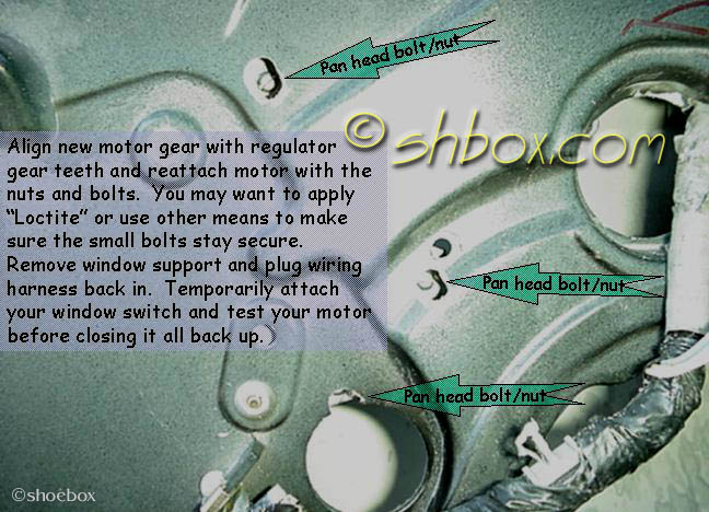

i installed it. worked great at first the only problem im having is that the motor sounds like its loose. when i press the button for the windows to go up, they go up all the way and it continues to go up and i can hear the gear grinding even after the window is all the way up. idk if the screws got loosened up. i saw the picture of the three holes to put the screws through on the motor to mount it but i couldnt get where the second one was suppose to screw into? im talking about the fourth hole on the top side of the motor in this picture? i know i put the screw in there but where does it mount onto? i couldnt find where so i only put in two screws http://www.shbox.com/page/windowmotor18.html
