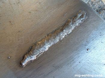

                  Ok so I have been reading more, and apparently it is normal to look like this with gasless wire:
                  And they say if you want it to look like a normal clean weld just clean it up with a wire brush and then it will look like this:
                  And also apparently since the slag is non conductive, after you say, tack weld, you would have to clean the slag off before you weld over it cause the slag would prevent a good connection since it is non-conductive.

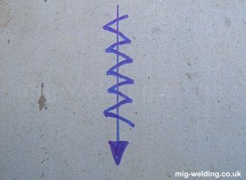

                  Also I guess since the slag is non-conductive you are then supposed to use just a zig-zag movement like this, so that you aren't going back over the non-conductive part to make a messy weld.
